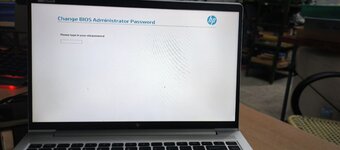

bios password removed sir. but it asked old password. i also tried command prompt. how to solve this issue?
Vahab Hemmati
Support Team
Staff member
Admin
i just removed the password from bios file.
but i don't know about any other password!
